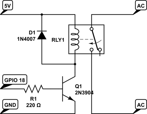

Though digital electronics use very little power, the things they control often require much more power. Even small mechanical devices like our relay require considerably more current (the flow of electrical energy) than the chip on our little Raspberry Pi is prepared to deliver. So we need to build an amplifier. The amplifier works a lot like our relay does: it allows us to control a large flow of power using a little one. In this case, our amplifier will be a simple transistor in what is named an open-collector configuration. This allows us to use the 3.3V output pin, which can only drive up to about 16mA of current (see here), and drive the coil of the relay which requires 5V at about 100mA. Here's the circuit for it:
Schematic for an open-collector amplifier to drive a relay using a GPIO pin on the Raspberry Pi
Here's a high-level explanation of how this circuit operates. When the GPIO signal is low, the transistor is off and doesn't allow any current to flow through the coil of the relay. When the GPIO signal is high, it activates the transistor, allowing current to flow through the coil, causing the relay to flip its internal switch. The 220 ohm resistor controls just how much current is pulled from the GPIO pin, and as a result, how much current flows through the coil of the relay. This particular value will draw about 12mA from the GPIO pin. Assuming the gain of the transistor is at least 10 (though it's likely between 30-80), this will allow at least 120mA to flow through the coil, or as much of that as the coil can draw, which in our case is 100mA at 5V. The diode is there to prevent any damage to the transistor or the Raspberry Pi from the inductive kickback that occurs when we try to switch off the magnetic coil.
