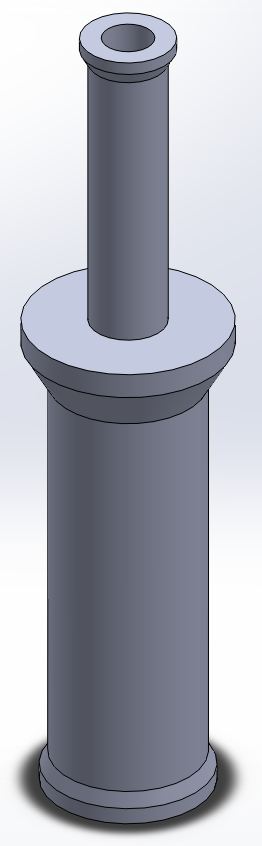

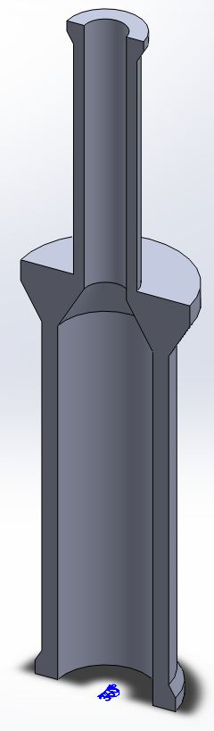

My hose adapter was made to go between 3/16" ID and 3/8" ID. The dimensions of the inner diameter of the adapter were taken from specs I found on another company's hose menders. Note how small the inner diameter is on this adapter: it's only 1/16"! Also, rather than use barbed ends, I added a lip. This is a common technique used on computer water cooling components. Although the hose doesn't tend to stay on by itself, if you use a hose clamp about 1/4" down from this lip, it presses the hose against the lip, creating a tight seal (note that the seal is between the hose and the lip, NOT the clamp itself). Part of the reason I did this was because I was worried that our 3D printer wouldn't have enough resolution to create a sharp edge for the barbs and also because it's difficult to build a steep, overhanging edge with a 3D printer without using some sort of temporary support that must be removed.

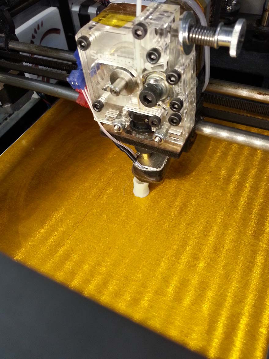

Here's the 3D printing in progress. As you can see, it's making a solid, consistent shape, with only a minimal amount of ripple. Unfortunately, I forgot to take a picture of the finished product. The 3/16" end wasn't quite as nice. It wasn't entirely straight and the layers each seemed to ooze out a bit, so there was significant ripple in the wall of the cylinder. So much so that you couldn't tell there was a lip on the end! Still, it was complete, relatively strong, and I could (with some effort) get air through the end. However, I eventually decided that the flow rate would be too low using this, so I went looking to build another one. And I snapped off the 3/16" end while trying to remove the 3/8" end from the hose. :cry:

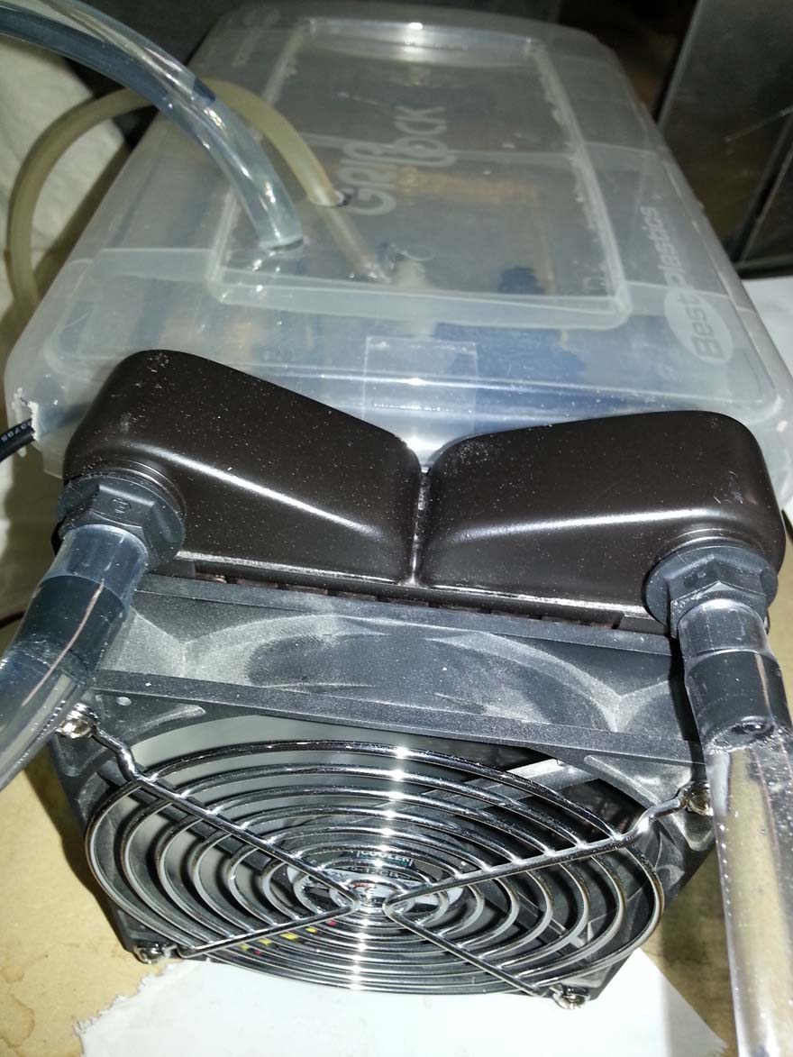

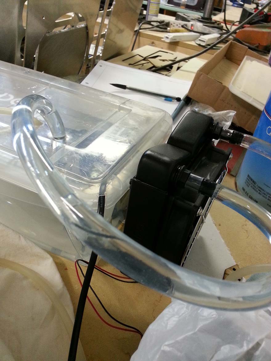

To keep the radiator and fan from falling over and becoming blocked, I attached them to the side of the reservoir using some stick-on cable anchors and cable ties. It's definitely a hack, but they are very flexible when it comes to fashioning methods to hold things together, as long as strength isn't a big issue. I also have bags of each, so I don't mind experimenting with them.
The fan itself is a 120mm computer fan that I pulled from an old machine. I cut off the standard PC fan molex connector and soldered on a 2.1mm DC barrel socket instead. I then found a 9V 1A power supply in a bin of spare parts that had a matching barrel plug. Although the fan is designed for 12V, it will run fine (though a bit slower) at 9V. It actually doesn't take much air flow through the radiator to keep it cool, since the radiator's design makes the heat transfer process very efficient. It runs slow, but silent, and there's a noticeable air flow coming through it.
Completed water system, reservoir and pump in front
Completed water system, side view with reservoir and pump on left, radiator and fan on right
Closeup of the radiator and fan with the attached fan grille
After assembling all the parts, I added water to the reservoir and turned it on. It sounded awful at first, partly because the pump seems to have some issues (a notable tick and grind noise) and because it was mostly dry to start. But as the pump started to prime, water started to flow and I could quickly see the air bubbles in the line travel into the reservoir and bubble away to the surface, leaving very little air bubbles trapped in the system. I then shook and tapped the lines and radiator, trying to dislodge trapped air pockets. After about 10 minutes, I had removed all the trapped air I could and the system was running smoothly. Any air still trapped will likely work its way out during operation, but shouldn't affect the overall effectiveness of the system.
The last step now is to add some sort of biocide to the water to prevent it from growing slimy algae. I filled it with distilled water to minimize the amount of microorganisms and minerals in the water, but things always have a way of getting into the system. Adding a silver coil would be the simplest way to manage the problem. Some people add various additives to their water, such as ethylene glycol, but many of these are counterproductive. For example, ethylene glycol (better known as antifreeze) is used in car cooling systems because it lowers the freezing point and raises the boiling point. However, we don't expect our water to get anywhere near freezing or boiling, so this isn't needed. It's also reduces the water's ability to transfer and hold heat. Finally, it's toxic, so now you have to worry about that. So for now it's just distilled water, but we should add silver or some other biocide in the near future to prevent algae growth damaging the equipment.
